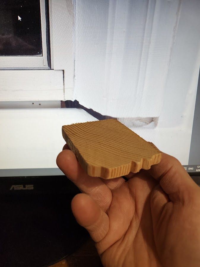

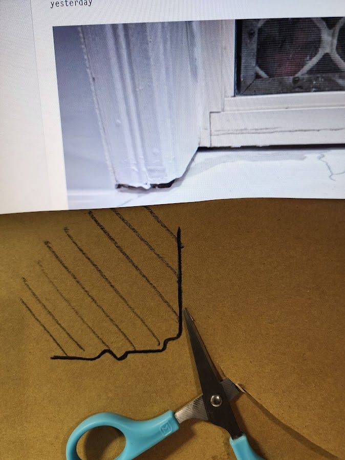

Just a coffee thought @DIY_110
The gap does look big to my eyes.
I was thinking of stiff cardboard and with a pair scissors keep cutting and nibbling till it slips in the gap with the correct profile.
Transfer this to a block of wood.
Cut to the correct thickness.
And with a chisel, coping saw, jigsaw, band-saw, multipurpose tool or whatever you have, cut the profile.
Glue in position. Maybe a little gap filler required. Paint.
Cheers.

One for each end - and then a nice tight fitting piece for under the window.
