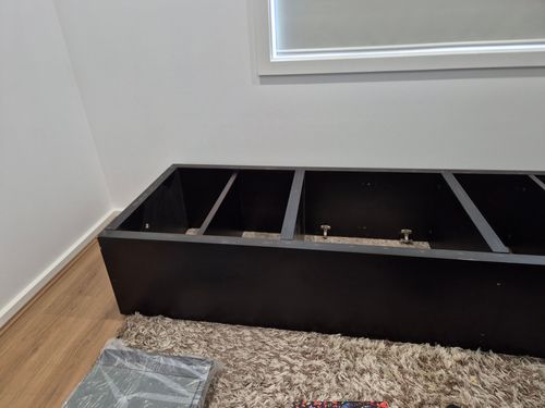

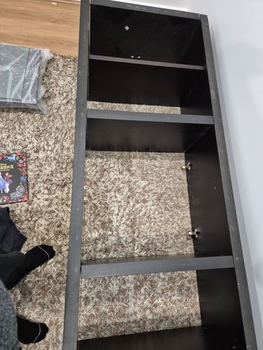

I'm trying to repair a TV tower unit that was damaged during a recent move. It completely came apart, and all the existing screws and bolts are now loose or stripped.

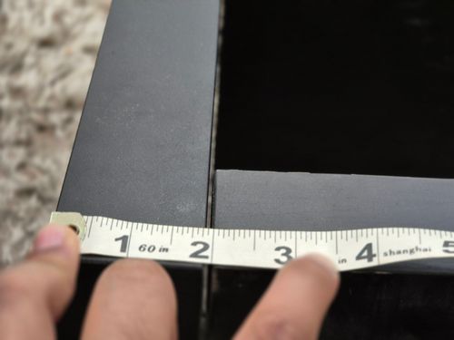

The material of the TV unit is **chipboard laminated with Formica**. The **vertical and horizontal boards are 1.8 inchesthick**.
My plan is to screw the whole thing together again — each level, on either side — using new screws to secure everything properly. I'm thinking of using wood screws to screw directly into the chipboard from the sides (probably pre-drill the holes to avoid splitting), but I want to make sure:

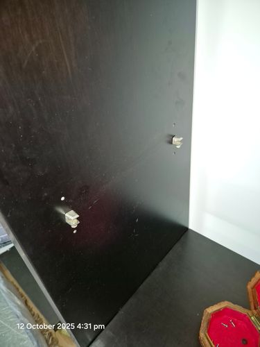

Could you also help advise what i need to buy to fix a the glass holder (sorry not sure what its called, ill attach pictures)
One of the components was damaged during the move!
The one in the picture with my finger had a cylindrical component which broke and needs replacing to fit into plug in the tower wall
Hello @jalal
I'm sorry but the store does not carry this type of shelf support. As an alternative, I propose using Taskmaster 6mm Nickel Plated Metal Shelf Support - 50 Pack and using Scotch™ 2.54 x 152.4cm Clear Mount Double-Sided Mounting Tape - 2.54cm x 1.52m on each shelf support to prevent the glass from moving.
