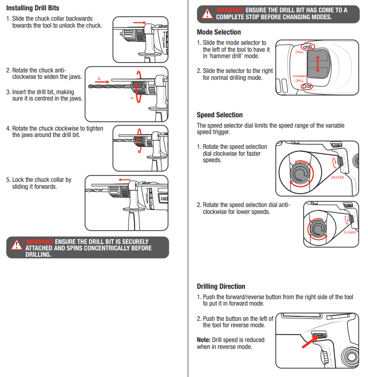

My apologies for the late reply. You've received excellent advice from our members in regards to a starter D.I.Y. drill. I just wanted to confirm what @AlanM52 has stated about hammer drills being used to drive timber screws. You can clearly see it on the Ozito 710W Hammer Drill. I've placed an image below to give you a better idea of its function. The corded drill has more power which you'll need when drilling into brick, masonry or steel.
