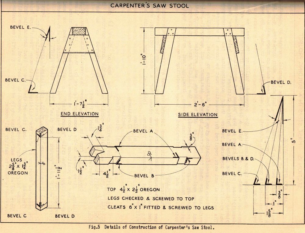

Found these in a Carpentry and Joinery textbook. Department of Labour and National Service.
October 1945....

Love old drawings and that first stool looks liek it would be pretty solid and handy to have about the place :smile: I would maybe add a vertical rail under the top horizontal surface so heavy things dont pressure it into a bend tho :smile: Not that we stand on our horses O:)

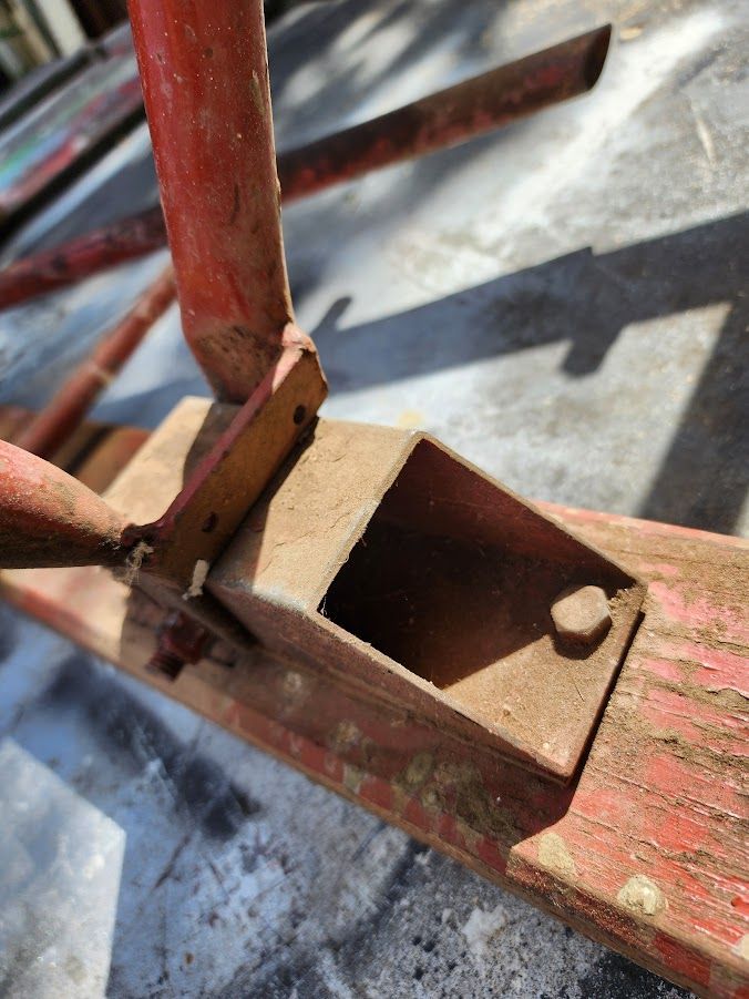

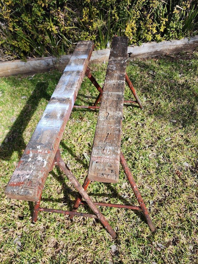

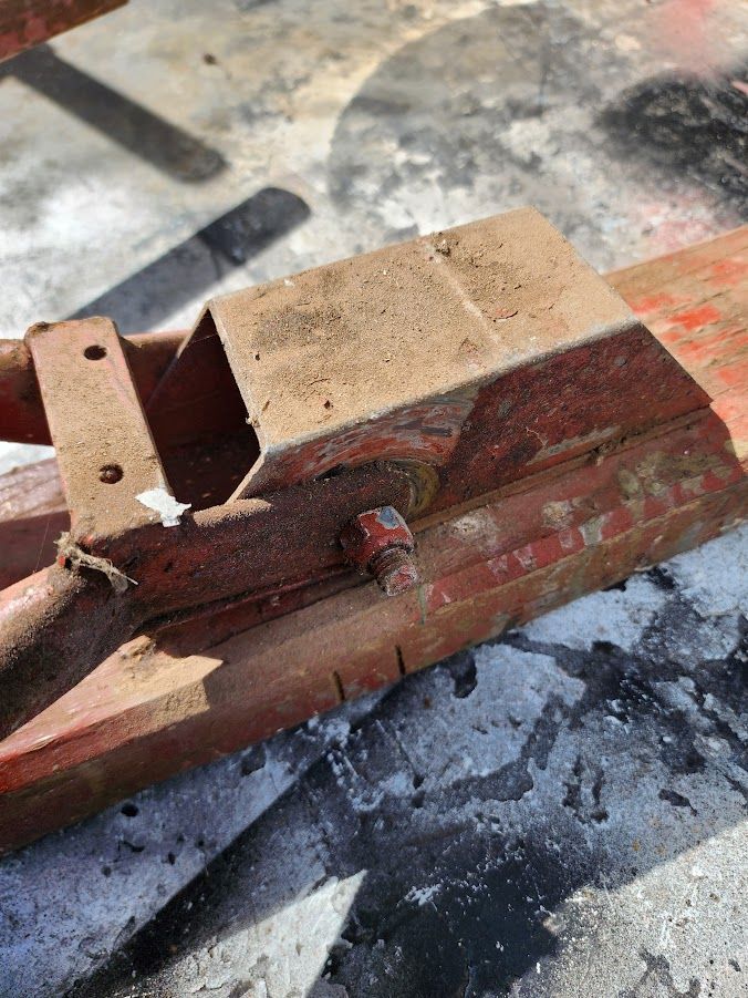

Just a bit more saw horse talk/history. These were my father's, probably from the early 70's.
Nothing remarkable, but I liked his hinging design - or maybe he got the idea from commercially made horses?
Square tube - cut at 45 degrees both ends - bolted to the wood.
Crush the ends flat of steel pipe - bend - and connect to the square tube with bolts.
Brace the legs - and fold back to the desired angle - weld a small piece of flat steel - to act as an 'inhibitor gauge.'
The bolt height at either end is different - to ensure the legs meet when folded.

:smile: How can saw horses be so interesting! 50 odd years and still going strong! :smile: I wonder how many sit arounds having a drink after a days work they have done :smile: Something about saw horses that makes for a relaxed and friendly setting.
Those saw horses of your dads look pretty useful being longer then normal.
