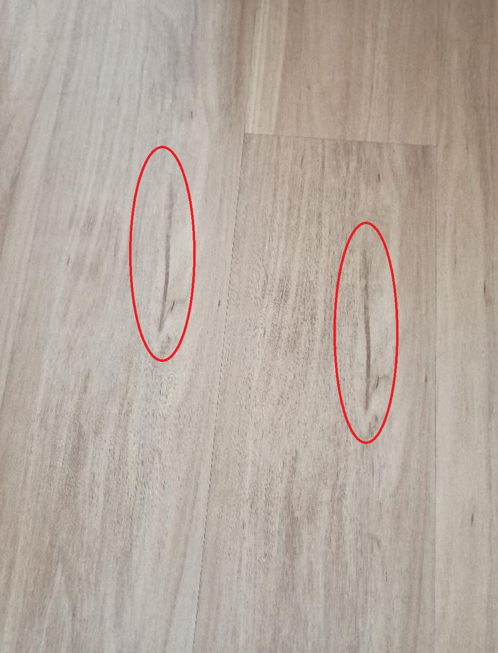

How to remove scuff marks on timber floor?
Hi,first post.
I recently bought some black rubber floor protector cups from Bunnings (38ml i think) for our dining room chairs to protect the timber panel floor.
I was shocked to find that the black rubber cups actually left score/scuff marks on the floor instead of protecting it so put felt tips on which work good but move and allow the same thing to happen again.
I've tried everything,toothpaste,WD40,baking soda mix,a rubber,magic eraser,tennis ball,fine scours to remove them and all they have done is dulled the scuffs a little.
Looking for suggestions to remove them completely?

Firstly, with the chair tips, if you are looking for something to protect the floor and allow the chairs to slide, then the felt pads are perfect. If you are looking for something that will stop the chairs from sliding and won't mark the flooring, then I'd suggest using clear chair tips.
From the photo we have, it is hard to tell if they are engineered timber flooring or if they are a timber look, tongue and groove vinyl flooring.
Are you aware of the type of flooring and the finish that is on it?
Generally speaking, you've exhausted the options that I would recommend without knowing the specifics of your flooring.
You could try a dedicated floor cleaner or polish, such as the OCedar Clean and Shine Timber Floor Cleaner that @AlanM52 mentioned, or other options such as Long Life Self Shining Floor Polish or Bona Wood Floor Cleaner, applying it with a microfibre cloth and working in a circular motion.
If a dedicated cleaner doesn't work and you've tried a scourer, you could try using some Super Fine Steel Wool.
If you can advise on the specific type of flooring, I could certainly assist further.

In the very first photo @LP100  - I see an elongated laminate 'pattern' repeated in both boards. They're perfectly matched to my eyes.
I see no rubber-based scuff marks?

I'm not an expert or have any knowledge or experience with the type of flooring but it has a coarse finish to the point suction cups wont stick to it and i suspect it's some kind of timber panel not vinyl with a clear finish.

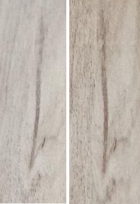

I just wanted to check, so we are on the same page. It's not these two patterns on your flooring that you are trying to remove, is it? If so, these are part of the flooring and mimic the timber's natural grain. You can see that they are identical, as it's essentially an image on the boards. Typically, you try to stagger these when laying so they don't end up next to each other with the same pattern.
If there are other marks on the boards, could you please point them out so we know what you need to remove?
